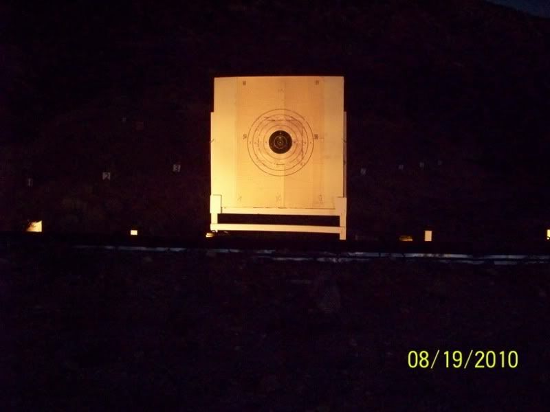

Some pictures from yesterday. I also have a video that I will post a little later.
I have a few more pictures with some shooters and I didn’t want to post them because maybe some shooters don’t want to be posted on the net. But if you guys think that it’s OK I will post them.
Christian

Lights look good...Why does the forum cutoff the right edge of all the photos postedshooter65 wrote:
